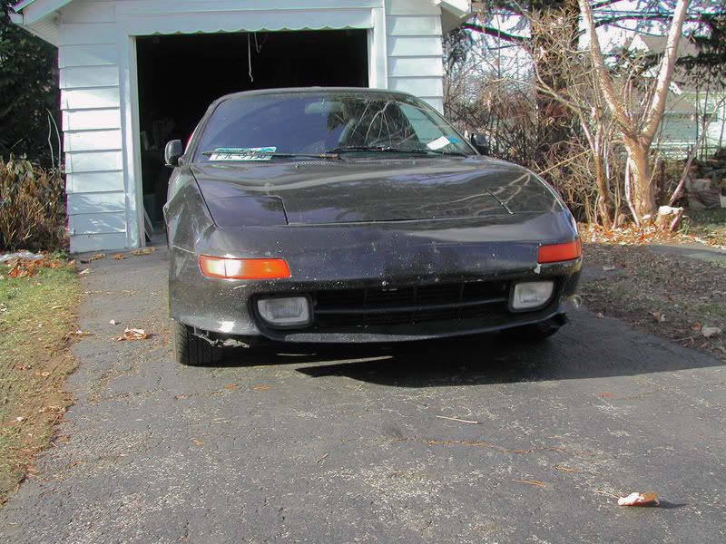

Sounds good so far. Only thing it needs is paint, its dark green and he was getting ready to re paint it( my friend who has it now, hes a clean freak) So its all in primer ready to go.
I think its this color if I remember correctly.
