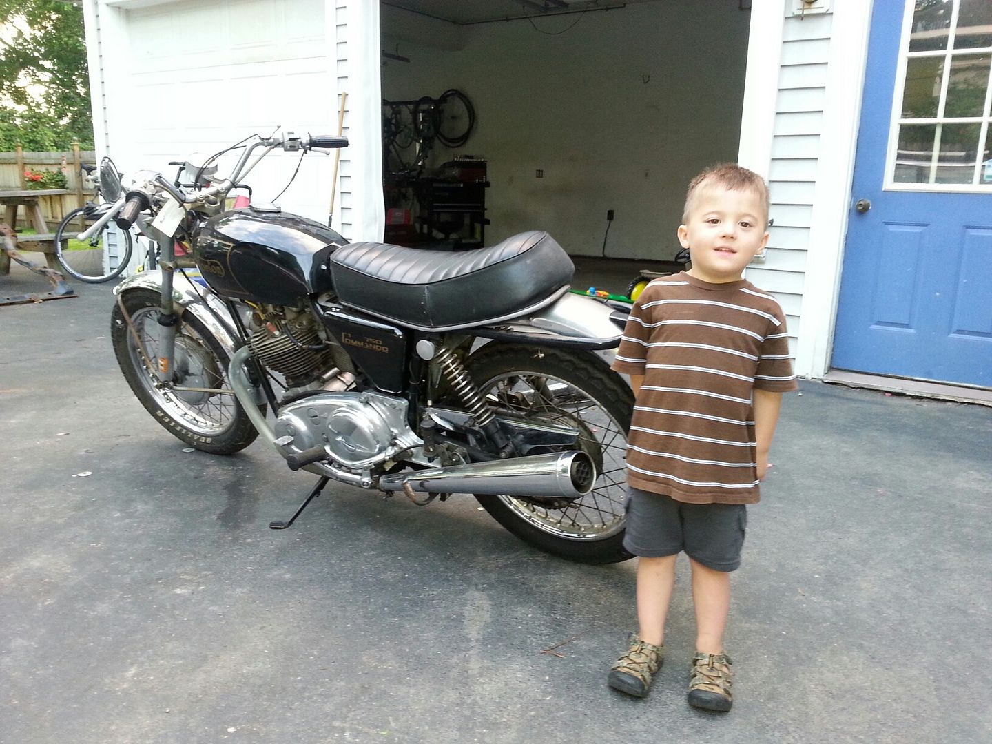

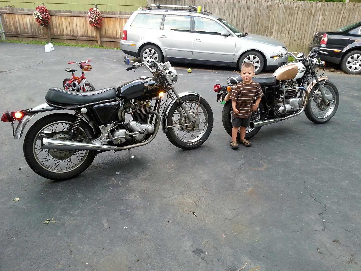

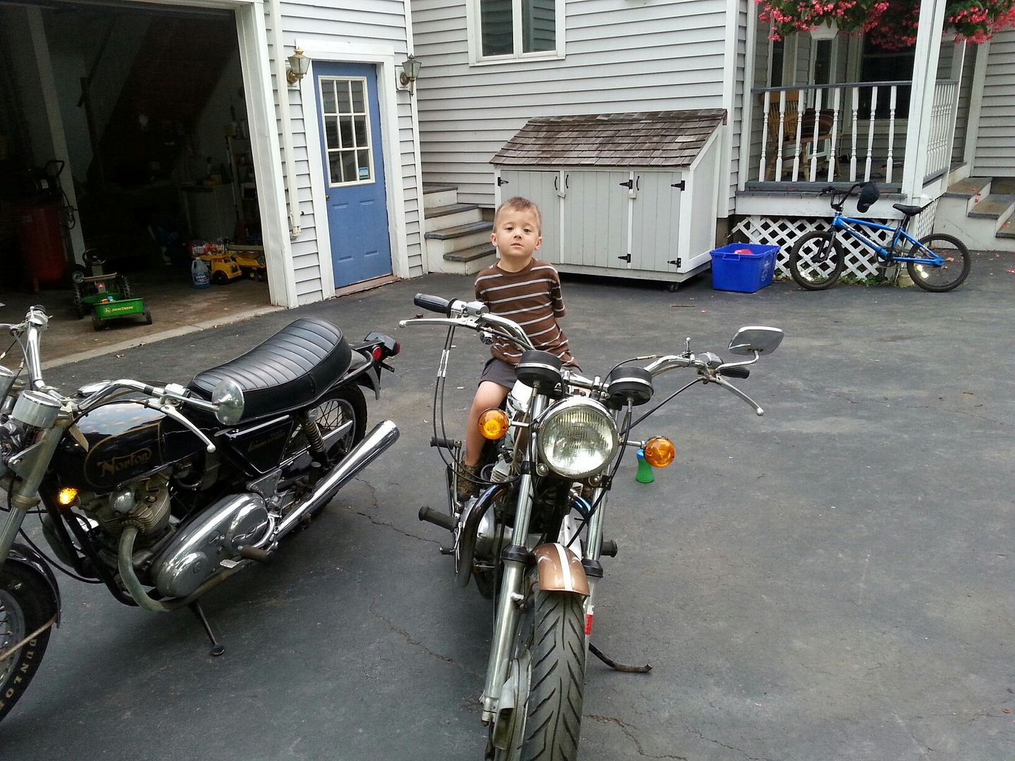

This thread needed some legit vintage-not 90’s “vintage.” Got the little fugger to say Norton and Triumph. Took him for a ride on the Triumph around the back yard-he LOVED it! He thinks the bikes are his already. I told him not till I’m in the ground.
:clap:^
Now THAT’s parenting.
He watches me fire up the Triumph, asks tons of questions, wants to help me turn on the fuel valve, helps me tickle the carbs, and watches me kick it over. I was inside washing my hands in the kitchen sink, look out the windows, the little bugger was trying to push down on the kick start with his arm to start it. I got misty eyed.
