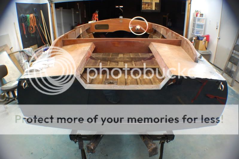

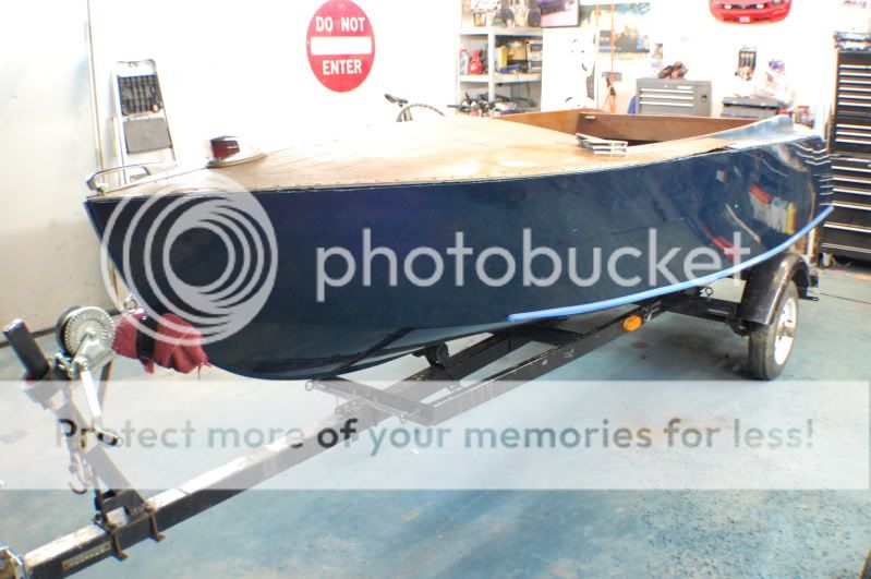

Tonight, got her flipped back over:) Used the same ratchet strap method, but had a friend help this time just in case…
On the trailer…threw the old top back on just to get a better visual of a somewhat finished looking boat, this won’t be used as it’s pretty beat up. This is a really shitty picture…
