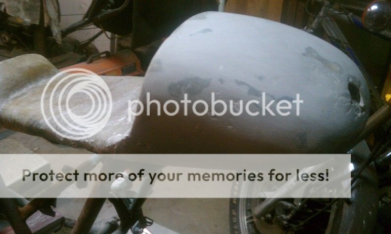

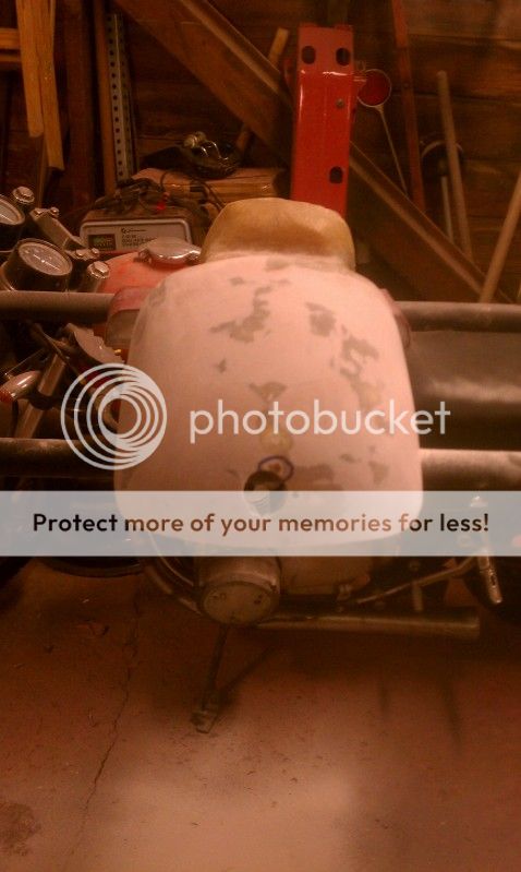

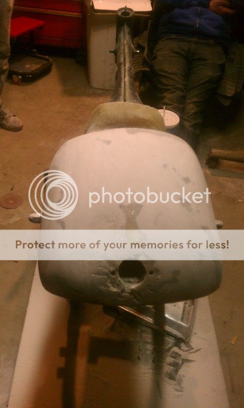

also did a bit of work to the seat pan. the hole is drilled for the flush mount tail light. did a little grinding and did a coat of duraglass. nick went BEAST MODE sanding the tail section for a solid half hr with no break haha. anyway on to the pics
first coat of duraglass
after sanding (still has a few low spots)

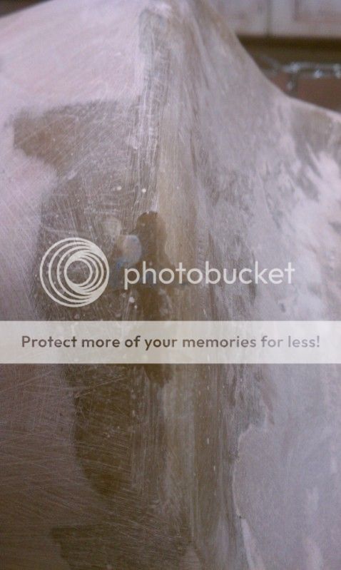

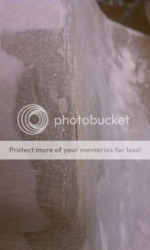

another coat of duraglass (ran out of duraglass after this coat, will get more. turned the empty can and turned it in to an ashtray… “duraglashtray”)
OOPS!
little glue fixed the crack right up
after sanding

The tail still looks twisted in all of those.
Otherwise, looks good. I would never have the patience for body work.
the part up by the tank isn’t cut evenly, so one side is quite a bit higher than the other and is making the whole thing look twisted…and the left side of the tail is a little lower than the right up near where it rolls over the edge to the butt-stop part of the sitting portion (if that description makes sense lol)

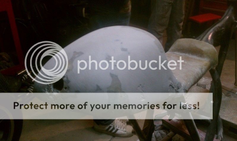

moar duraglas!
bit of sanding, lows marked
front where it meets the tank, filed down a bit. still a lower on the right side
im hoping to do one more duraglas layer on the “butt stop” part of the tail section, and a layer on the part that meets the tank, and the one edge thats low. sand all that down to have the final shape, then do a finial skim coat over the whole thing before sealing it
