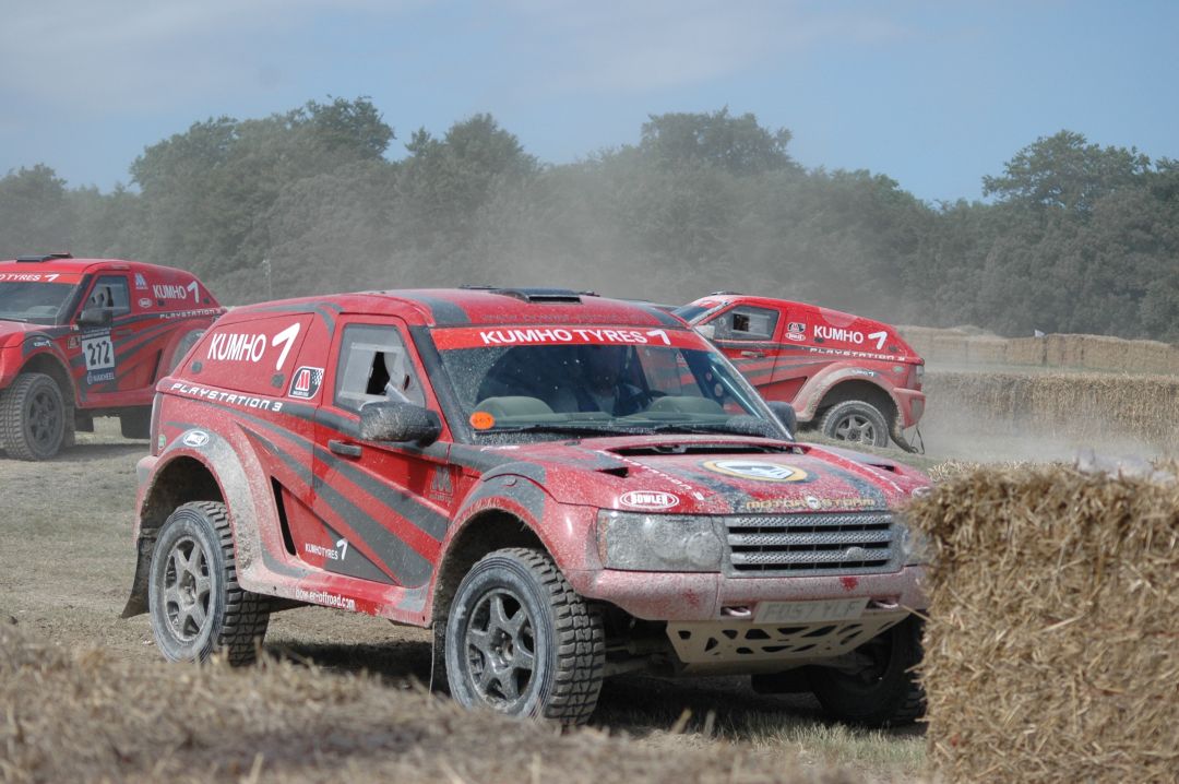

Yeah it’s quite the change visually but I plan to try it out. The wheels are actually an off road racing wheel, not some purely decorative thing. They’re light weight too, so with the right tire I may actually have less unsprung weight than I do now:
https://www.comp.co.uk/
… If I ever start gutting my interior to save weight someone smack me, lol.
