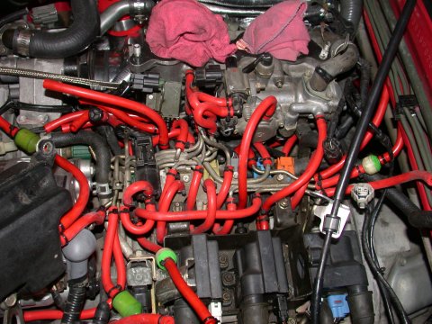

Have you ever seen the vac system for an rx7? It is like a big plate of spaghetti
http://www.negative-camber.org/crispyrx7/vacuumhosebefore.jpg
