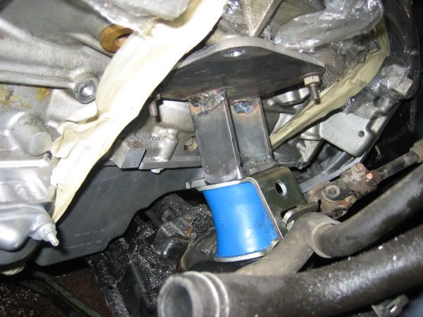

heres an example of softmounts in an s13… you can sort of see the notched crossmember as well it looks like
http://i37.photobucket.com/albums/e100/ls1240sx/mounts/IMG_0009-small.jpg

1=using modified crossmember template from hinson…will weld up myself.
2=will use stock headers and bastardize the driver side to go around the steering…might even make a log manifold …not sure yet…will have to see if a block hugger header might work…
3=will use aftermarket clutch…and stock 240sx clutch cylinder and pedal, will fab up a custom plate to actuate t-56 throwout
4=will use my current 3 inch single exhaust with a cross over from the other bank…should flow ok
5=will use a painless wiring kit…4 wires to hook up plus engine connectors they also come with the anti theft delete for the ecu and all relays and fuses…they are all labled…so it should be easy enough
